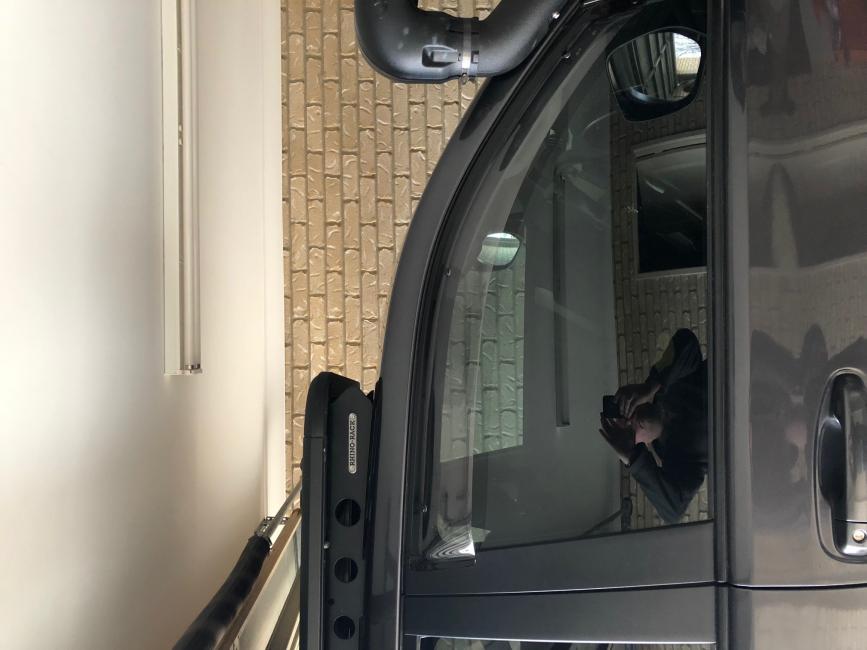

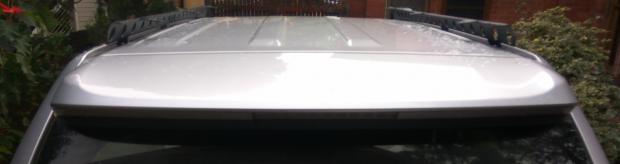

                  • Roksy18, I have the 1928 rack. Hopefully the attached is enough to show how far it is set back. I installed it as per the instructions. Phot doesn't seem to want to upload for some reason and I'm still tired after night shift to look in to why. (I'll see what I can do tomorrow). But the rack front is not quite half way (maybe1/3) through the bottom length of the front window (if that makes sense?)

                      Thanks Roksy18 now I get to see where they sit before I fit mine, look great
                      • Thanks baazang for the photos. 1928mm version looks better suited to my needs

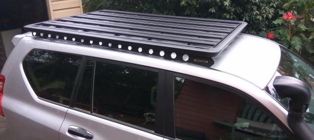

                          • 1928mm version on my 150
