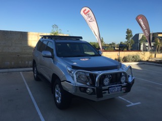

                I have the pioneer rhino bar fitted looks great
