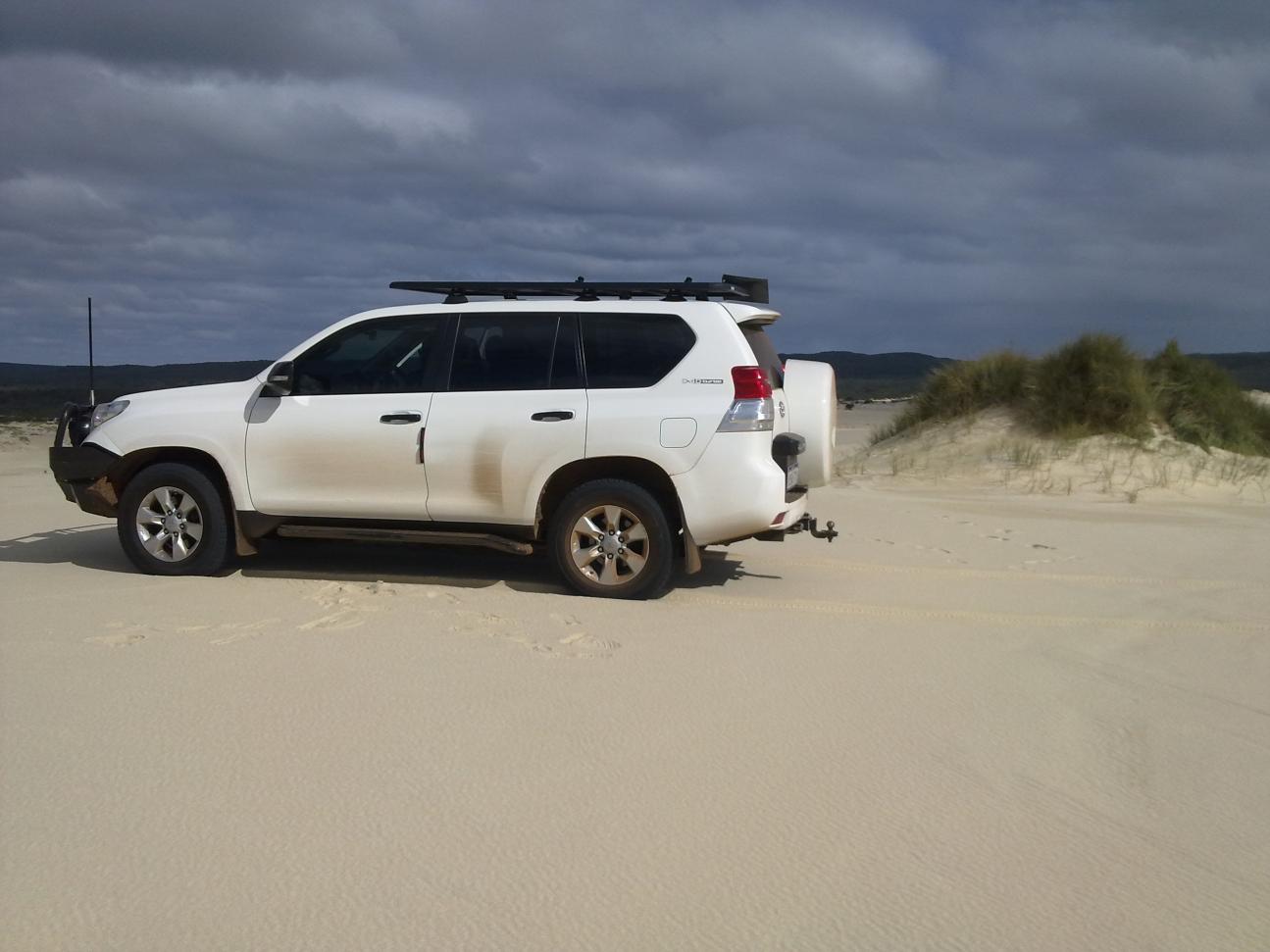

Hi Will, I have a RhinoRack Pioneer 42107B which is the 2128mm length model and it is fixed to the Prado using the 6 feet in the RLCP23 kit. When looking at the car from the side it appears that the rack does not sit more or less parallel to the line of the roof of the Prado, with the front tending to be higher than the back (have tried to attach photos). The front feet seem to be 15 -20mm too long/high (has anybody else noticed this), will the new backbone system correct this. Also, just a small thing, the Allen Keys with the hole in them seem to be a very poor fit and do not last long with frequent use when I have to frequently remove rack attachments to get into my garage. Cheers.
Originally posted by Nebulous View PostHi Will, I have a RhinoRack Pioneer 42107B which is the 2128mm length model and it is fixed to the Prado using the 6 feet in the RLCP23 kit. When looking at the car from the side it appears that the rack does not sit more or less parallel to the line of the roof of the Prado, with the front tending to be higher than the back (have tried to attach photos). The front feet seem to be 15 -20mm too long/high (has anybody else noticed this), will the new backbone system correct this. Also, just a small thing, the Allen Keys with the hole in them seem to be a very poor fit and do not last long with frequent use when I have to frequently remove rack attachments to get into my garage. Cheers.
Hello Nebulous, thanks for posting the image of your car and Pioneer platform, and hopefully Will is able to reply soon. It appears to me that the gap between the roof and the Platform widens not so much due to the mounting legs being too long, but rather due to the roof line "falling away" towards the front of the car. I am on the verge of getting a platform, and have got some information etc, and a roof rack specialist company advised me NOT to get the 2128 mm long Platform for the Prado, but rather the 42102B, version, which is 1928 mm long as the longer version comes too far forward in their opinion.
After seeing your image I would agree, unfortunately. I don't think the solution will be to shorten the mounting legs, as the platform needs to be more of less parallel to the main part of the roof line, and it also needs to be completely straight across the full length. Anyway, lets see what information Will provides, but I am leaning towards the 42102B model Platform (1928mm X 1236mm) on the same RLCP23 mounting legs, which will be 200mm shorter at the front. Its a shame about the current Allen key. The last Allen key supplied with my previous Rhino roof cage lasted well...hopefully Rhino can ensure that the allen key is fit for purpose....However, this time I won't be removing my platform once its installed, hopefully, which is why I like the idea of a lower profile 'platform' rather than a roof 'tray' with sides.SE Qld: GX 150GD Auto, (Feb'16 build): TJM T15 steel b bar, 9,500lb TORQ winch, TJM s steps, Rhino Pioneer Platform (42102B 1928X1236mm), front recovery points, Wynnum towbar, P3 brake controller, TNN Underbody guards, UHF, TREKtable & LED striplight, Custom Fridge & Drawers, Waeco CFX50, 9inch illuminator 160W LED spots, 40mm lifted Dobinson Suspension (Zordo's), ScanguageII, 30 Sec Wing Awning
