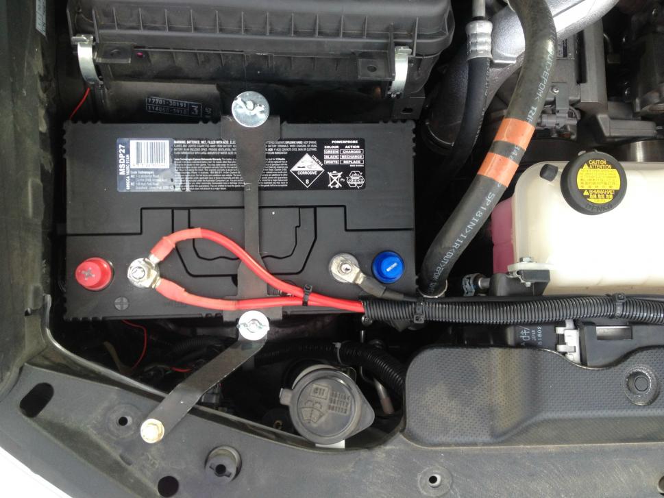

                    • #85
                      Mine was same date and model with no mods and just 50k. Crack under cranking battery, other side just had a normal tray with no crack.
                      [B]Steve[/B]
                      • #86
                        Thanks for the replies krypto and brogers. Can you post a photo of the brace please. No point in me re-inventing the wheel. The last time I tried it ended up square with the axle in one corner!
                        • #87
                          Hi Clancy, Toyota fitted the patch kit to fix mine as it was still under warranty. I think the part number is somewhere in this thread. It was fitted from underneath the guard and matches the profile of the guard so it is impossible to see as it was re coated with the black sound deadening.
                          [B]Steve[/B]
                          • #88
                            I just googled this image, just as an example, so you get the idea, and I know it shows a battery on the driver's side, but you can see the metal brace, linking the battery hold down post at one end, and bolting to an existing hole in the upper, front, engine bay cross member at the other end...its all about bracing the battery to stop a rocking motion as you drive over rough country.
                            I guess you could make something up yourself, or there are some propriety battery trays that have this brace.
                            Krypto is correct in saying that there is a part from toyota to reinforce the guard. Simply welding the crack even with a small patch didn't work for me, it just cracked again adjacent to the patch. I would be inclined to ensure the battery is well braced, with a connection to the front upper engine bay cross member, (like in the image) ..and also install the guard overlay patch.
                            Its a shame, seems to be a weak point in the Prado, and I understand that in the new model this has been reinforced....I hope so.
                            brogers
