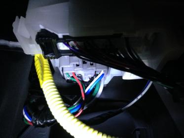

Further to Prone's info above I've traced the thicker grey wire and tested it along the way. From me on another thread:
The grey wire indeed runs right from the LHS rear R23 socket through socket AR2 in the LHS footwell to a 30A fuse in the engine bay. My fuse however is marked 'Towing' (facelifted MY14 GXL). I haven't checked the green wire you mention.
White/black is an earth wire as described.
After confirming that this circuit doesn't power anything else (my CD is in the mail) I'd be happy to split this Grey wire prior to the footwell connector (see pics); use the live side to power the controller; and the tail as the 'blue' wire to the rear plug. One of those 'repair tails' would be handy here prone for a very neat install straight into the connector. I'll pick up the purple at the brake peddle for signal. Missed anything?

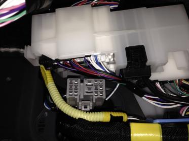

Does any one know what the following connectors are used for in the 150?
1. White plug right at the bottom of the driver's side front panel (in front of knees) under the knee airbag and switches. One tiny socket is battery power.
2. Grey socket inside engine bay, right hand side about 40cm or so from the rear of the engine area. This grey plug arrangement, connected to the RH side wall has two fat wires plus 2 small, one being green. Connected to the big wiring tube coming from inside the car interior.
I am wanting ignition on power in the right hand side engine bay to trigger a relay to power a front camera I installed. I do not want to use wires inside driver's area / dash.Prado GXL 2012 Charcoal - Drifta Drawers, Cargo Barrier, Sidewinder Dual Battery kit, Ironman Bar, Narva lights, Safari Snorkel, Airbags, TX3350 kit, Waeco CFX65DZ - often seen with Thule 2.2M narrow roof pod and towing 2014 Kimberley Kamper. Could be anywhere!
1. The first plug your asking about is the vehicle diagnostic plug by the sound of it. I would NOT recommend wiring anything to it except diagnostic tools or scanguage type equipment as its a direct 'feed' from the ECU.Originally posted by peterpanner View PostDoes any one know what the following connectors are used for in the 150?
2. Im not sure of the second plug your asking about but if you need an ignition feed try the un-used diesel heater socket on the other side of the engine bay. See earlier posts in this thread for further info.
