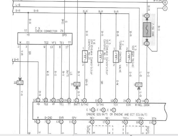

So just to double check I should find the red/black wire in the ECU and get a temp wire from it directly to the TCV and the green/white I should connect it directly to power from the battery?FJ70-1989 / LJ70-1987 / RJ70-1988 / HDJ75-1991-1HD-FTE / RN135L-1991 4Runner All SOLD

Just checked and it says other way round I attached a picOriginally posted by scottkz View Postthe series 1 wiring diagram i have says red/black goes to the ECU and the blue wire goes to power....FJ70-1989 / LJ70-1987 / RJ70-1988 / HDJ75-1991-1HD-FTE / RN135L-1991 4Runner All SOLD

I have Red/Black and Green/White to the TCV. Below are the several trials I did and the conclusion.
1)Temp wire from ECU directly to TCV :
No change at all.
2)Give ground (-) directly to the body of the TCV sensor:
Engine sounds much better and no rattling till it hits 2500 RPM and it starts to rattle and unstable.
Any suggestions? I have a EGR sensor as it's European specs, can it be the one causing this ?FJ70-1989 / LJ70-1987 / RJ70-1988 / HDJ75-1991-1HD-FTE / RN135L-1991 4Runner All SOLD

Yes this is what I did direct power to the red/black wire and temp wire from ECU to green/whiteFJ70-1989 / LJ70-1987 / RJ70-1988 / HDJ75-1991-1HD-FTE / RN135L-1991 4Runner All SOLD
