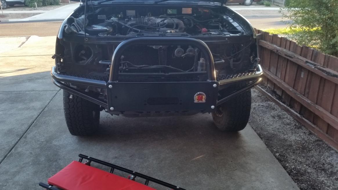

    • Picked up my new XROX bar and battery tray, hope we get some decent weather to fit it

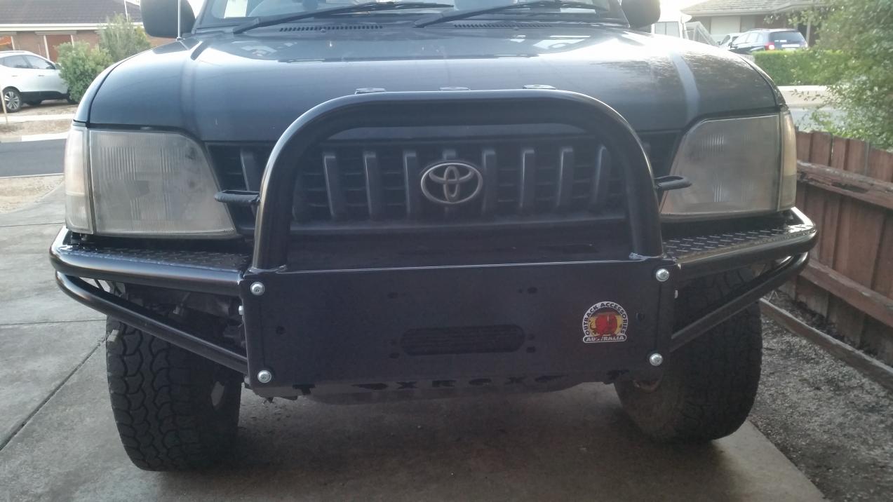

      • Fitted the XROX bar, reasonably straight forward, , duel batt is next

        • Originally posted by oceanracer View Post
          Bar looks great in black !!!
          Are you going to fit a lightbar to the top of the bar? Looks like you have lots of mounting points already installed to the bar.
          Not sure about yourself, but i found the headlight glass was a little frosted like, maybe with age and even the highbeam was pretty lowsy. Much improvement with a LED lightbar though.

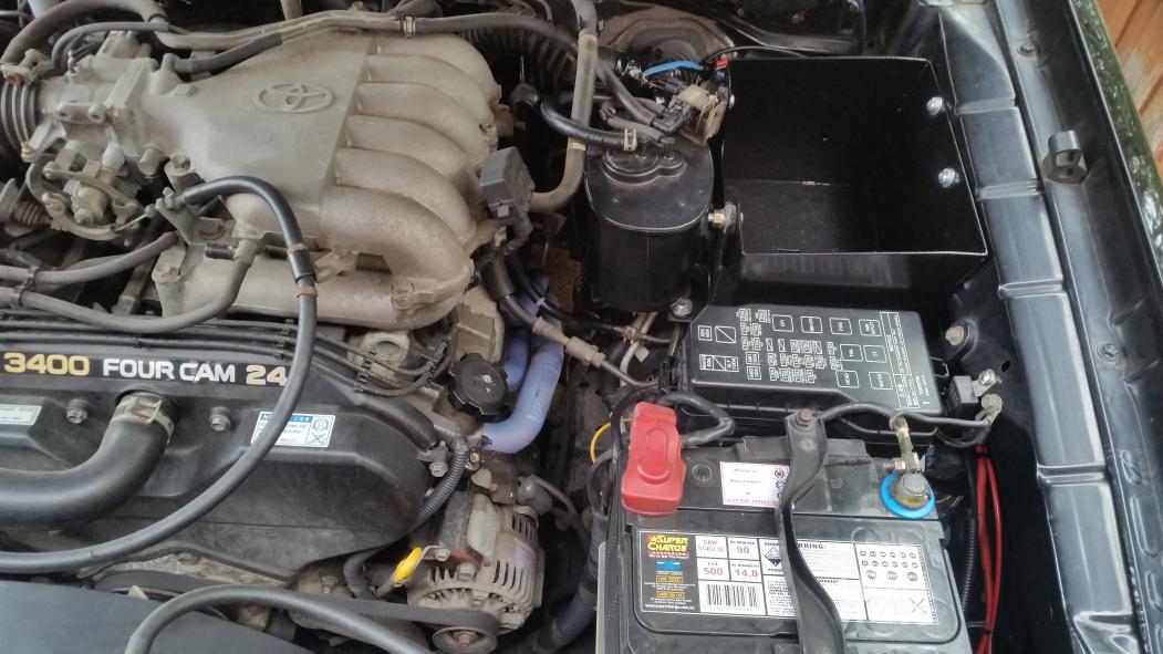

                  • fitted a duel battery box, need to get the elec bits now if anyone has any opinions on the brands to use

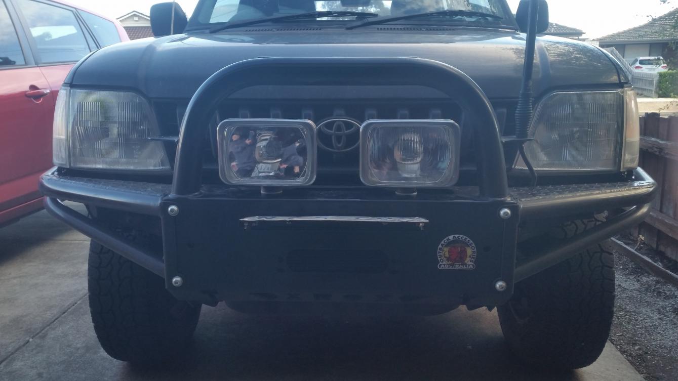

                      • Giving the old IPF lights a birthday before I fit them to the new bar

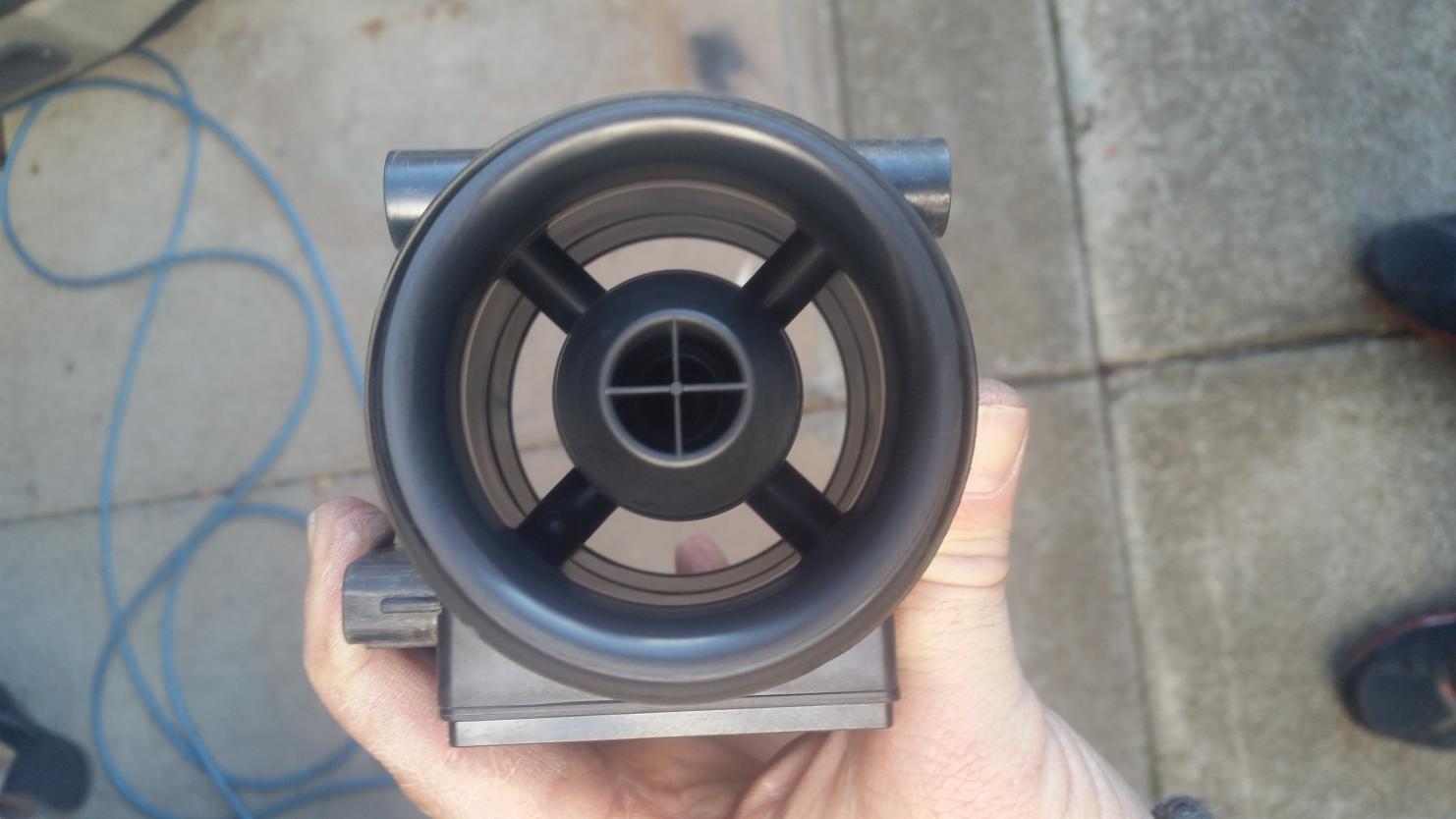

                        • Re fitted the lights and cleaned the MAF

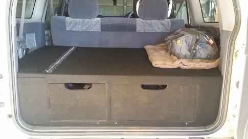

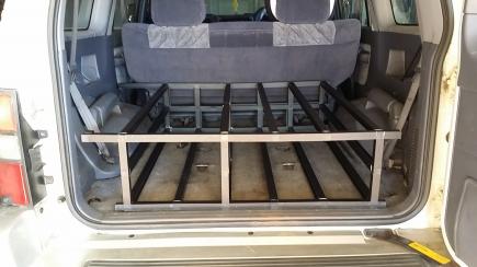

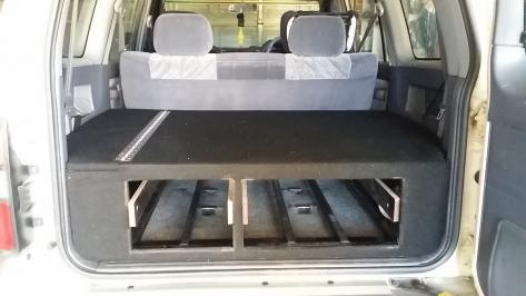

                                After the missus complained (rightly so i have to admit) of my work gear rolling around in the back of the Prado, she requested a better solution.
                                After seeing the inflated prices of a custom set of drawers to fit, i decided to make up a set to keep the back of the Prado looking much more presentable.
                                Used 25.4mm aluminium square c/w quiklok connectors for the frame, and 17mm film board for the top and drawers.
                                With hd hinges around 1000mm long at around $100 a pair, i decided to make 75mm plywood timber slides as a much cheaper option. More effort to pull/push, but for the cost saving can't complain about that.
                                Had to put in a hinged compartment on the passenger side to gain access to the jack when required, also stores the towbar neck/ball.
                                All mistakes covered up with some black carpet
