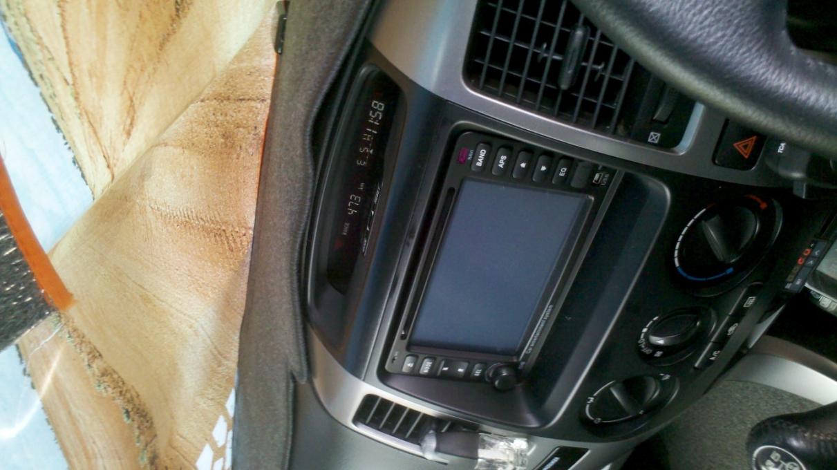

        • #49
          Here's a pic, Grande MFD installed into my 12/05 GXL.
Name:	2013-12-11_11-59-17_398 (Medium).jpg

                  • #54
                    [ATTACH=CONFIG]14225[/ATTACH]
                    Mick
                    Did you have to modify the plastic surround to fit the buttons at the bottom or does that plastic surround come with it?
                    Andrew
                    2005 VX Diesel - [URL="http://www.pradopoint.com/viewtopic.php?f=38&t=12823"]My Rig Buildup[/URL]
                    [URL="http://www.fuelly.com/smallsig-metric/65233.png"][img]http://www.fuelly.com/smallsig-metric/65233.png[/URL][/img]
                    [B]Bitumen - A blantant waste of taxpayers money![/B]
                    [URL="http://www.pradopoint.com/viewtopic.php?f=38&t=12197&start=0&st=0&sk=t&sd=d"][/URL]
                    • #55
                      No, it comes complete with the surround and assembled with the ECU, Buttons, screen and surround.
                      Two screws and one plug and you are done.
