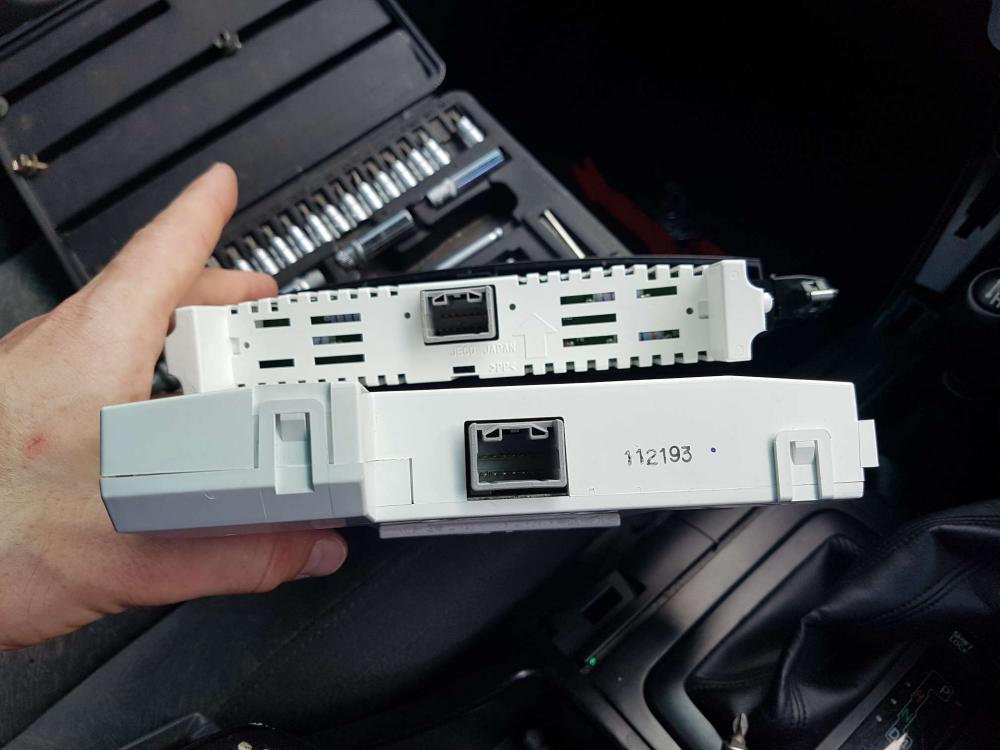

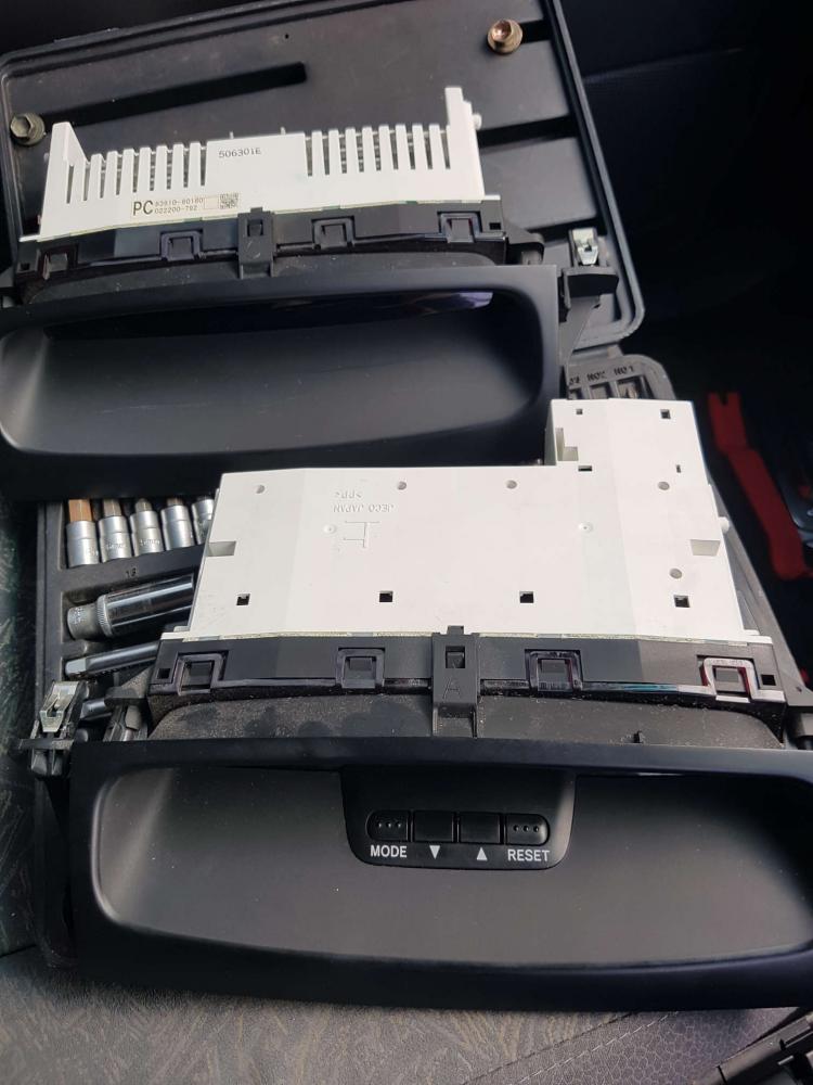

Picked up one of these bad boys. So easy to install, about 15 minutes.
Powered on the car and its displayed in imperial! (actually wasn't too much a surprise, ebay pics showed it was imperial. I assumed the car ECU would send which type of measurement to use).
Anyone know how to change the measurement type? I had a look at some of the American/Canadian forums and they suggest it can only be done at the dealer. I guess through an OBD cable and software..
I dont think it can be changed as the computer systems are all set up for non metric measurements. Sounds like it was out of a Lexus GX470 which was the Prado 120 series equivalent in the US but with a V8 engine. Keep looking in Aus and i am sure one will turn up. As i said i waited a couple of months but kept looking daily.2008 V6 GXL Graphite, Sovereign bar, LED spotties, BFG A/T tyres, King Springs on rear with KYB off road shocks, Engel 40lt fridge, Dual batteries, Uniden CB.
