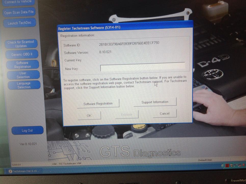

            hi guys, got a old acer XP laptop, I think it's a 32 bit one (not very computer savvy!) but it come up with this message. I was under the impression it would work but I need this number. Where will I find that! Lol.

              Did you download this form the ft86club link? if so you have to follow the instructions in the text file to bypass the code requirement.
              Mick
                      Mick
                      Didn't download it mick, she was a eBay jobbie! Hopefully a way around it. I followed the link on new hilux forum but it must be a different version didn't have anything about a registration number.
                      Cheers.

                            • Got a techstream cable coming on a slow boat from china and thought I'd download the software in advance. It's downloaded ok from the previous link off the 86club website. But I'm having trouble with getting around the activation key code. I've read bits and pieces about changing a file?? But either details are vague or I'm missing something. Can anyone help please.
                              • Not sure how to help, open the file, change the 0 to a 1, save it and you are good to go.
                                You need to find the line they are referring too. If you are appending the line then it may be your problem.
                                Mick
