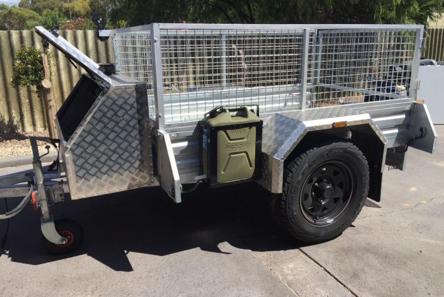

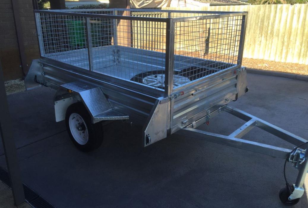

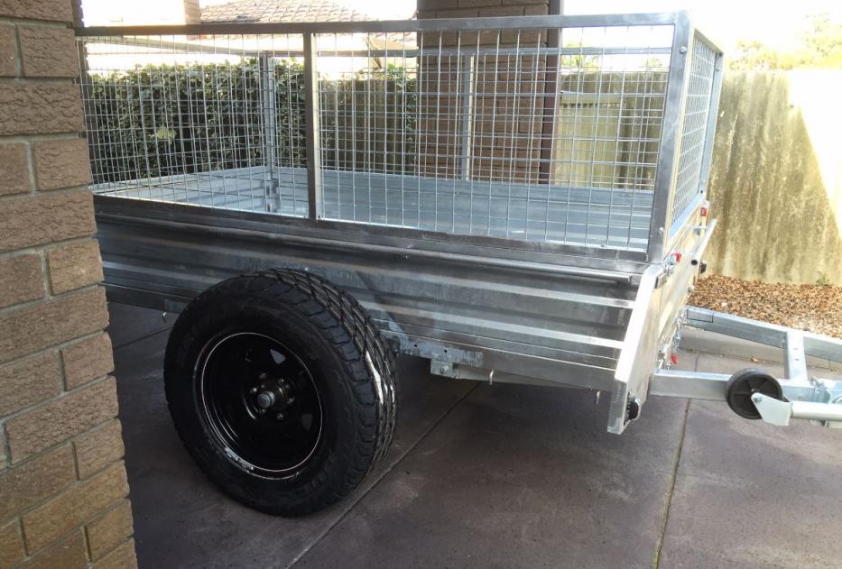

                          Last year I bought a cheap hot dipped galvinised 7x4 caged box trailer new for $1200. Once home, I instantly ripped off the axle and springs and upgraded to a bigger axle with Toyota hubs. This was an obvious weak point in the trailer but the rest seems OK. I put some new black 6 stud 17" steel wheels and matching tyres to suit the Prado. I added some large checker plate aluminium wheel guards to match the new much larger tyres. I've also added a nice aluminium toolbox up front and some plastic water jerry cans on the side. Inside the toolbox is a battery and 12V water pump and spiral hose connected to the jerry cans. There's a solar panel on the toolbox to keep the battery charged. I can put a rooftop tent on top of the cage when needed for camping.
                          Other things I've added are...9kg gas bottle mount, pneumatic tyred jockey wheel, LED floodlights on a 3 metre swiveling pole and a low profile off-road trailer coupling (Ark) so the Prado rear door can still open.
                          Current spend is a tad over $3k including the trailer. Rego is around 60 bucks a year.
                          To be honest, it's hard to tell I'm towing it as it's still small and light but certainly frees up space inside my Prado and there is hardly any change in fuel economy. I can notice it.....when towing on very soft sand if I don't let its tyres down but letting the Prado's tyres down is normally enough.
                          At the end of the day, I can still use it as a box trailer to go to the tip as everything is added around the outside and not the inside.

                              Here's a few stages of change. Still more to add - it's never ending. I'm now looking for some aluminium storage boxes to sit behind each wheel guard to fill the space to the rear.
