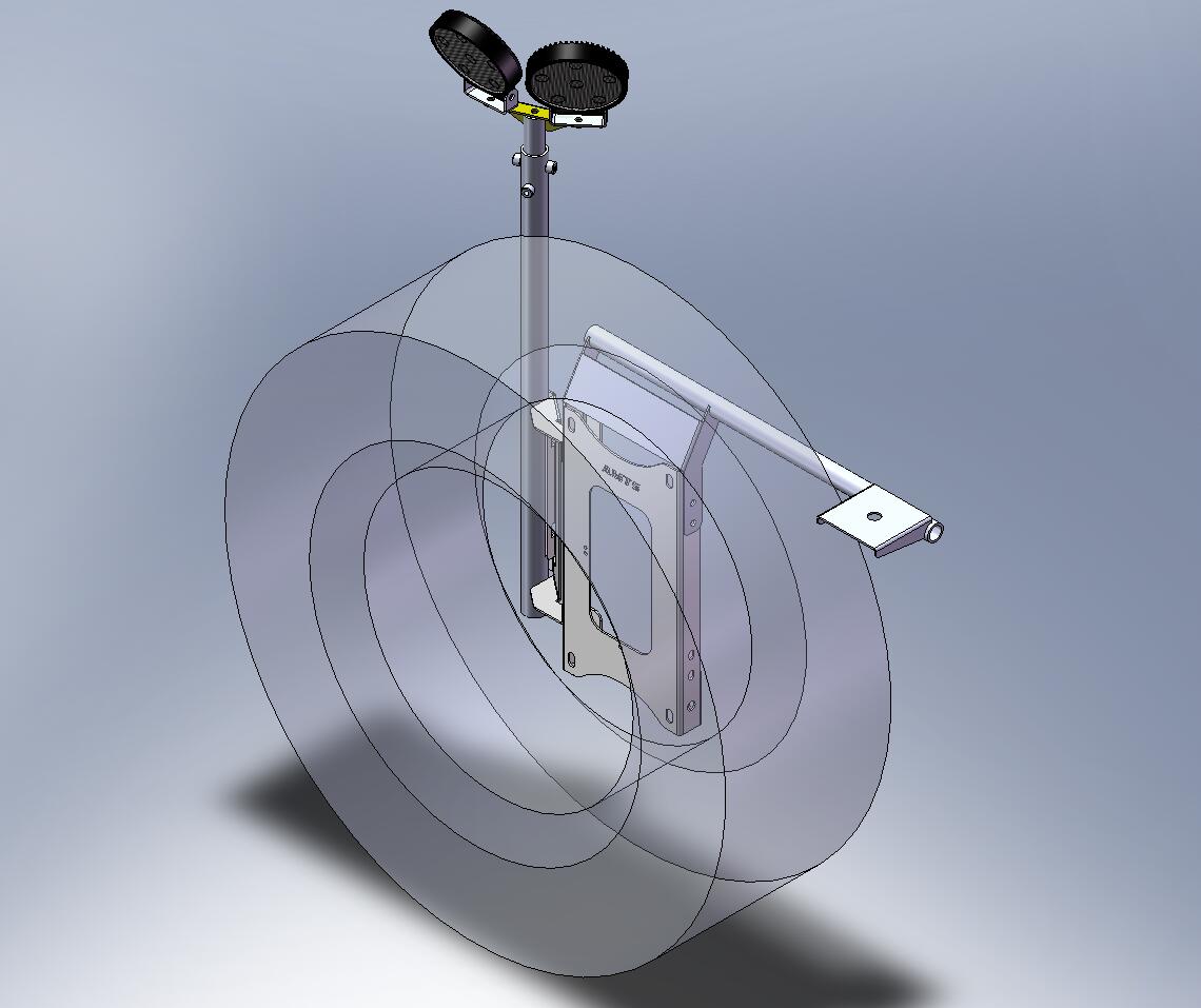

                No, not yet. How does a Codan antenna attach (the base looks pretty big) and is there a preference for it being on the left or right side of the tyre? I assume right side would be better for vision out the rear window but what about the shadowing effects of all the metal (i.e. the side pillars) affecting the reception of the antenna?
                  You are correct about the right side being best to keep it out of the line of sight but the antenna is usually mounted so that the radiating part (the whip) is above the roof line (have a look at mine in my build thread). The base of the Codan is 110mm square with an M16 hole for mounting. The tuning section is 790mm long so the mount needs to be this much below the roof line.

                    • So a bit like this?

                      • Yes, but do bear in mind it weighs a total of 5.7kg (incl. whip and spring) and tends to flex quite a bit so the mount needs to be fairly substantial.

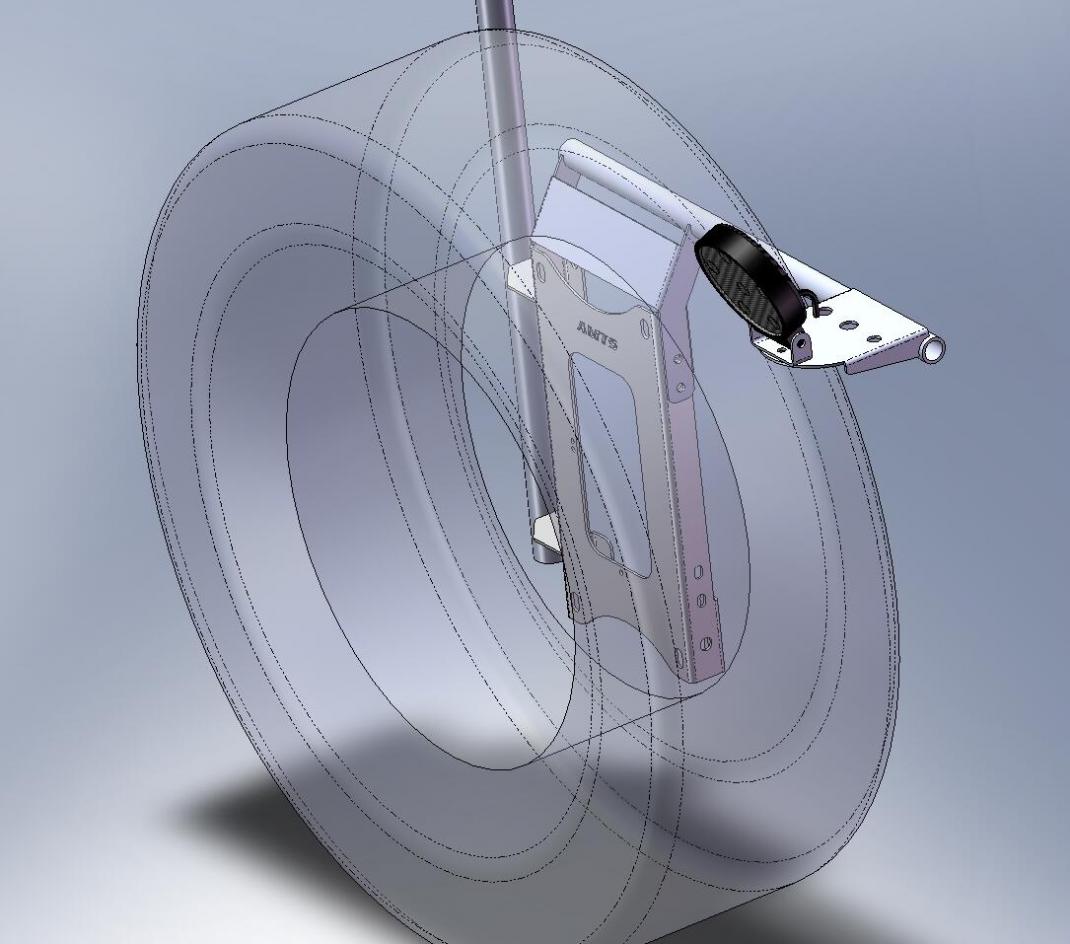

                        • Changed the mount to allow for a light with HF; or light with UHF and sand flag.

                          • Looks great, hopefully will be available for the 150 ;-)
                            Having a lower light and an upper light would be useful.
                            Good work AMTS.
                            Bernie

                                Thanks Bernie. There's never enough lights.
