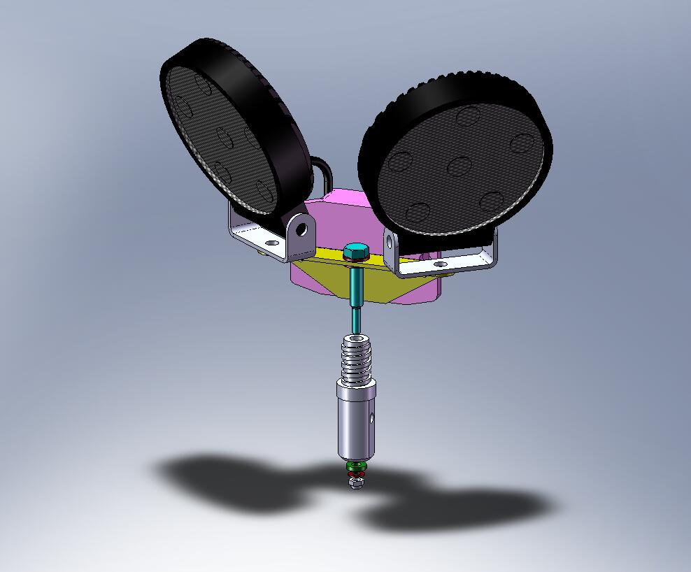

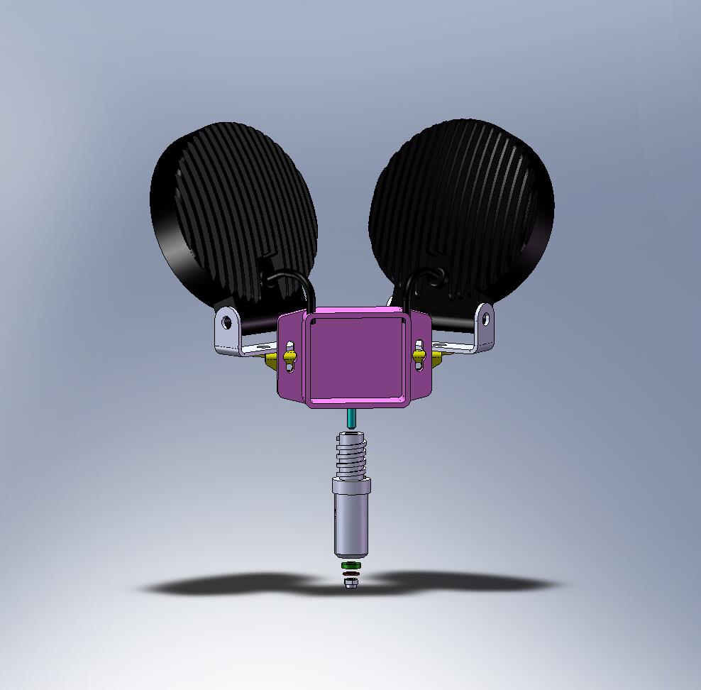

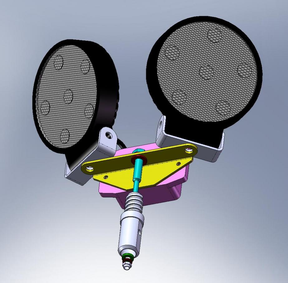

                      • Some furhther developments. This is the pic of the twin light mount on top of the pole. The pink box at the back is a waterproof junction box from jaycar (http://www.jaycar.com.au/productView.asp?ID=HB6211 ).
Name:	twin light assy.jpg
                        rear view
Name:	twin light assy rear view.jpg
                        bottom view
Name:	twin light assy bottom view.jpg

                        • Hi Andrew,
                          From the picture, does the nut at the bottom screw onto the shaft of the light assembly?
                          (As in....what stops it poping off if driving with the lights mounted?)
                          Updated!!! looked at previous posts on the pole, I can now understand that it is used the screw the shaft on. And won't interfere with the "quick mount" system for the pole.

                          • Yes, it does. pictures above are from the exploded view. Refer to pic in this post of how it is all bolted up
                            http://www.pradopoint.com/showthread...l=1#post358313
