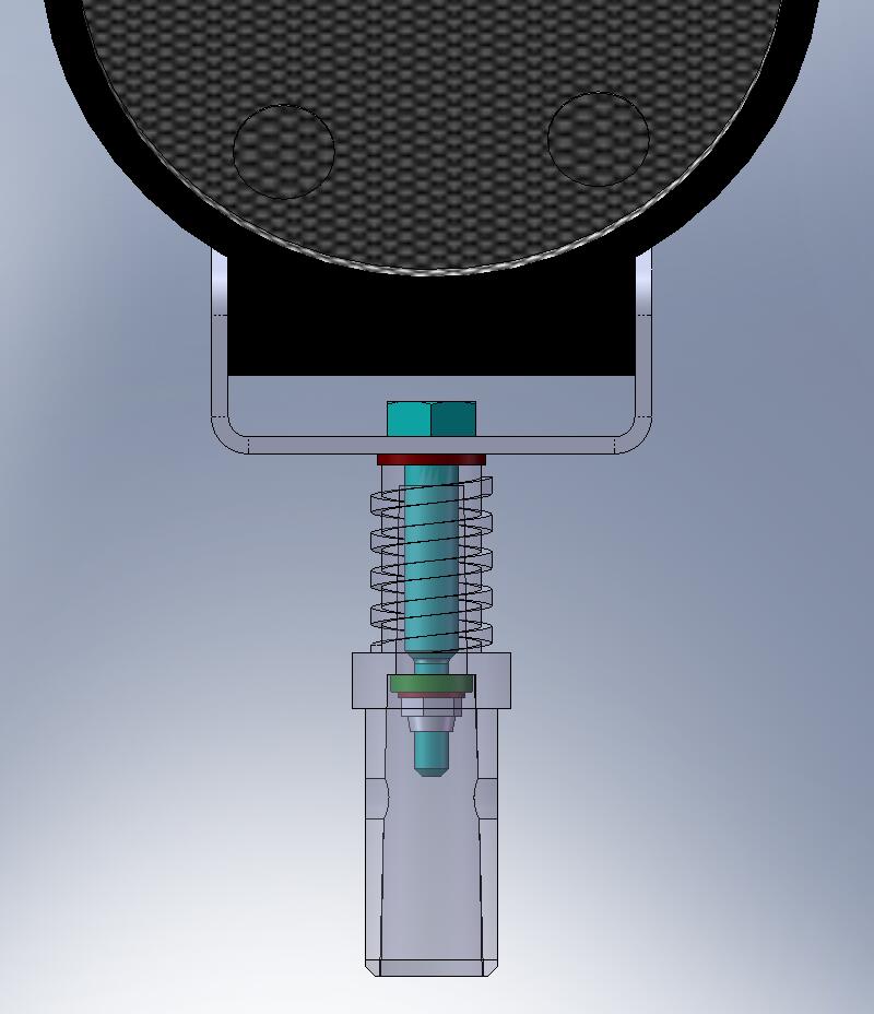

                            • Here is the CAD model of how the light is assembled on the cast ally adaptor from the telescopic pole.
Name:	detachable light.jpg
                              The M8 bolt that comes with these types of lights is replaced with a longer bolt with a reduced M5 thread at the end. The red washers are nylon washers which allows the light to swivel. The dark green washer is a custom washer to provide a seat for the M5 nylock to bolt up against.
                              • Much better pole Andrew. I'm sure it'll all be worth the wait.
                                Is the M8/5 bolt one of your customs?
                                I was going to shorten the threaded roller plug but I guess if done your way, the pole can still do double duty as a paint pole
