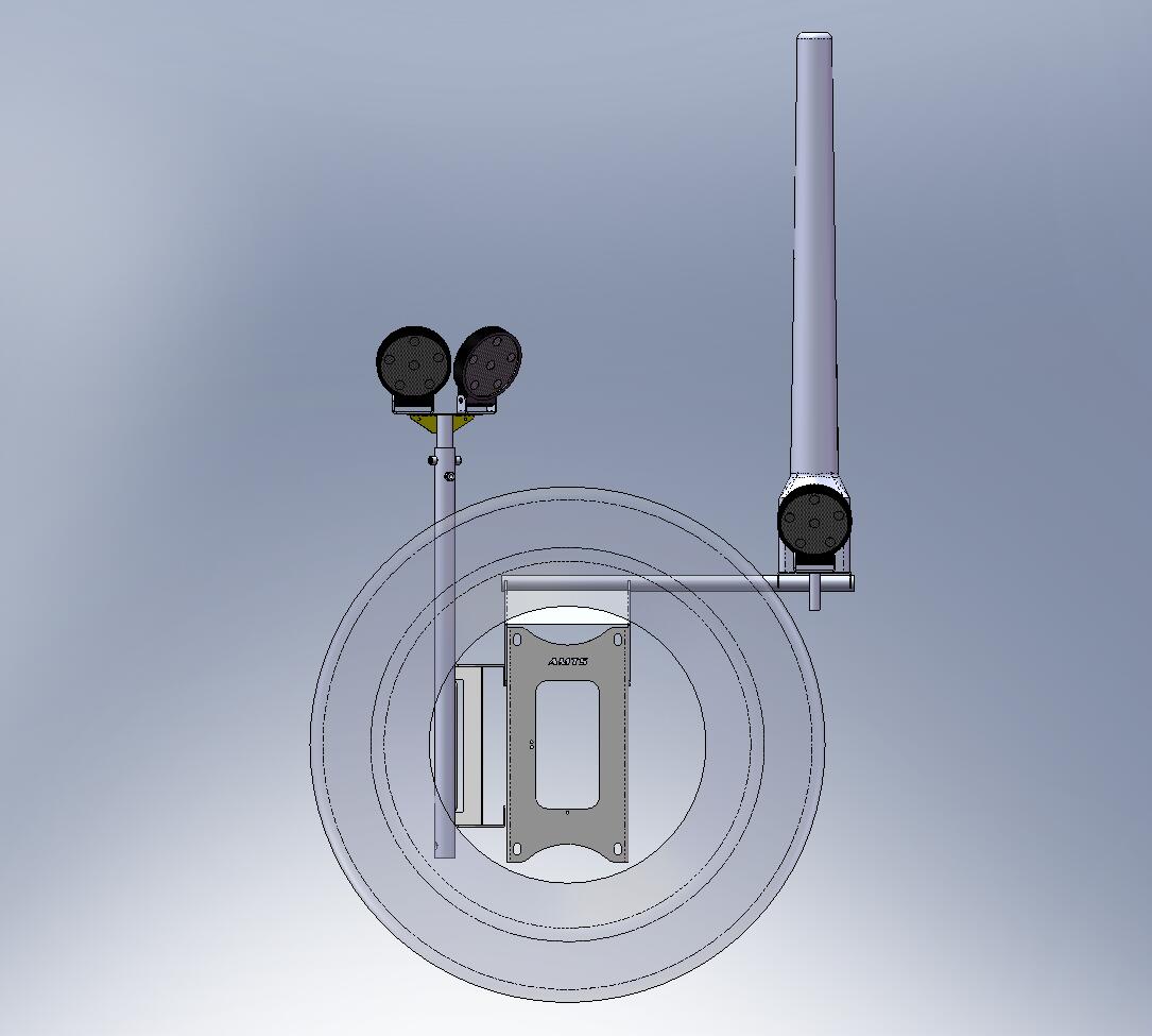

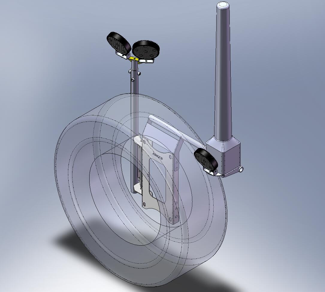

    • OK Stuart.
      I think the HF tuner might be sitting a bit high...
Name:	120 tyre spacer with light and hf mount 3.jpg
ID:	644659Click image for larger version
Name:	120 tyre spacer with light and hf mount 3 end view.jpg
        OK Stuart.
        [ATTACH=CONFIG]11646[/ATTACH][ATTACH=CONFIG]11647[/ATTACH]
        Hi Andrew,
        With mine the top of the tuner is level with the top of my Pioneer Platform and the base sits about 1/3 of the way down from the top mounting bolts for the spare wheel carrier. I can take some measurements and photo's if it will help - just let me know.
        • Yep, way too high then. Looks like it needs to come down 200mm. Pipe bender anyone?
            I've just been out to check and 200mm is about right based on your CAD drawings.
            • Thanks Trekkie. Back to the drawing board.

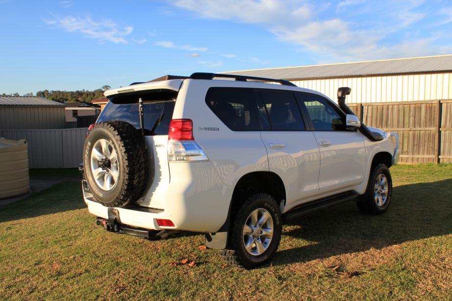

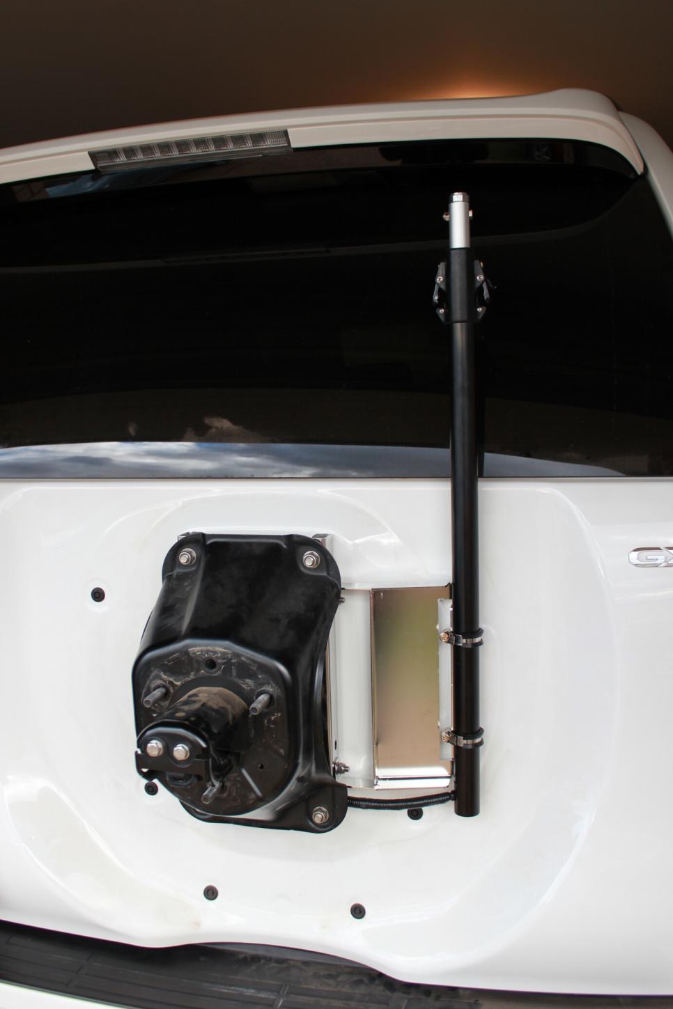

                    • I'll just leave these here....
ID:	644669Click image for larger version
                      • Thank you rwo for spending the time in helping to test out the prototype light pole bracket for the 150. Great outcome considering that we are 1500km apart.
                          Not a problem at all mate, happy to be able to give something back to the community!

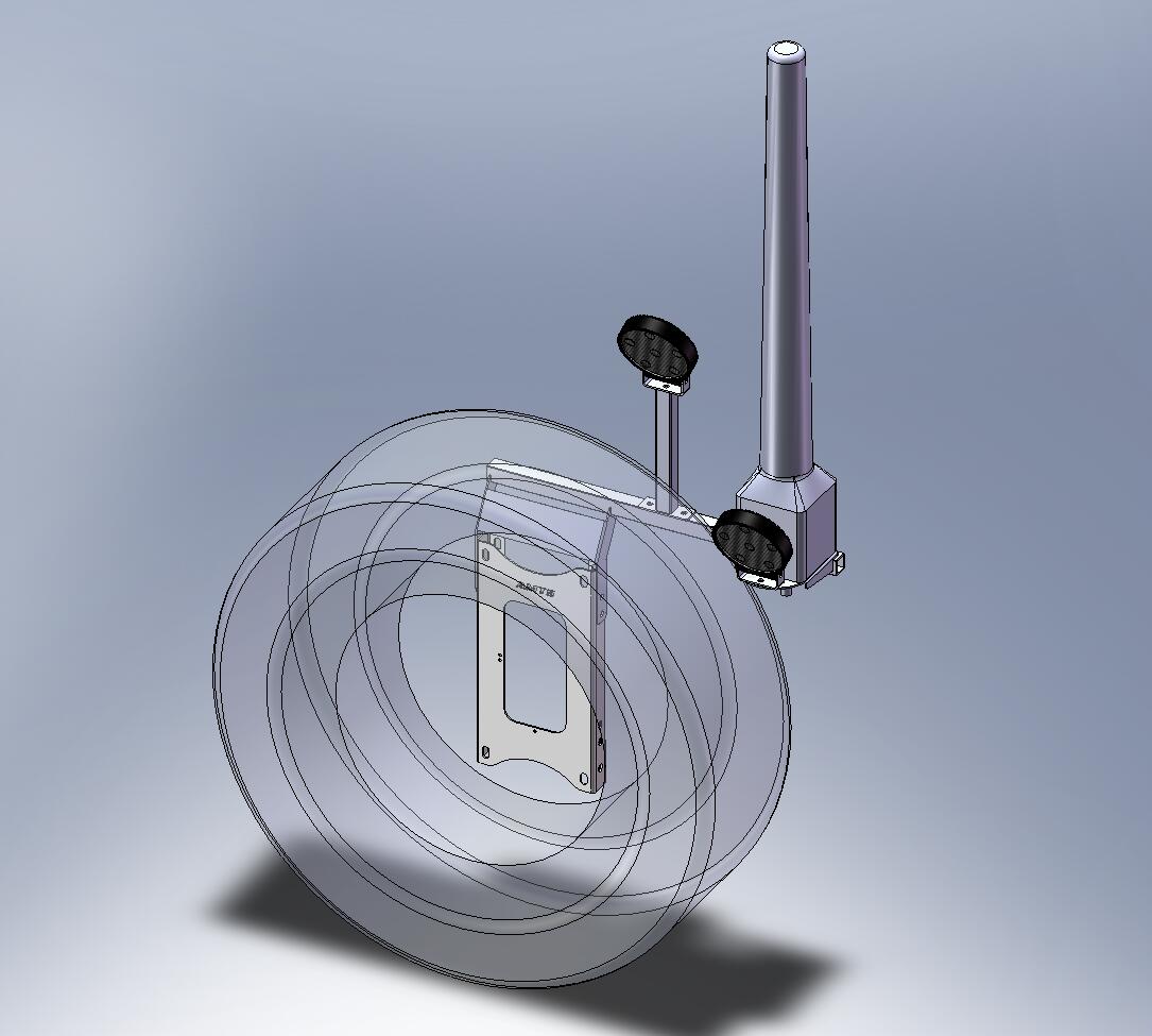

                          • Had a better look today about mounting the HF antenna. Due to the wiper on the 120, it is impossible to place the telescopic light pole on the left of the spacer. So if the HF bracket is mounted, the antenna will come out to the right of the tyre and there will not be room for any telescopic light pole. However, there might be a possibility of a fixed pole attached to the horizontal pole.
Name:	120 tyre spacer with light and hf mount 4.jpg
                            Different story for the 150 as the wiper comes down from the spoiler. So the telescopic light can be on the left and HF antenna on the right.
