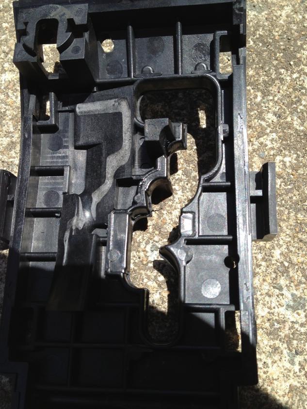

    No, mine isn't more worn. The track is moulded into the cover of the gear shift. Yours looks like someone has put a layer of material (what you call the FRP) over the original track and the top layer has worn down to expose the fibre.
    I would open up the box again and see if you can remove that material and revert back to the original track. I think the previous owner encountered the same problem and had a different approach to solve it.
      Photo prob doesn't show it well, the light shows the wear well but makes the track look different colour. I think the plastic used to make the cover looks to be FRP, usually when moulding FRP the surface has a shine to it, but if surface is removed, you see the firbe giving a rough appearance (similar to concrete)
      This photo shows it better

        you can see the track that the old bullet has worn out after i cleaned the old grease off:

          You're welcome Scott. It looks like the wear in the track is what's causing the bullet to jump out or crack the top of the collar holding the bullet. I've had a few now who have bought the kit after experiencing the gear lever jammed or become totally sloppy during a trip. So based on your pic and waltec's it would be wise for the older 120s (or those who like to shift through the gate a lot) to have the bullet changed out before the inevitable happens in the middle of 4WDriving.
