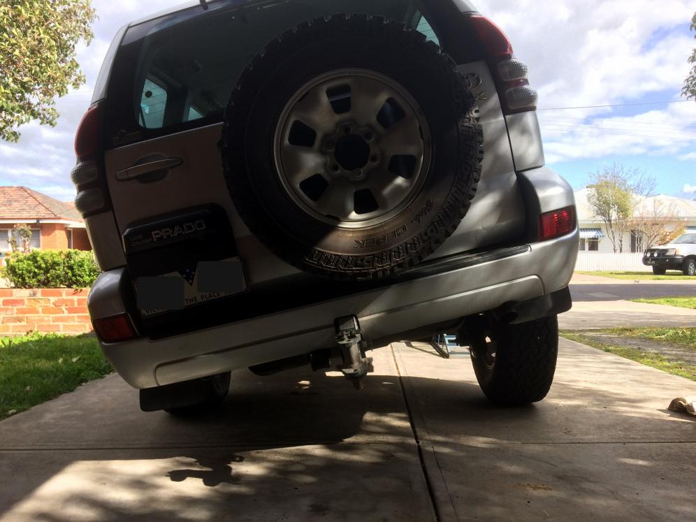

                    One issue I do have that I don't recall others mentioning is that at full flex (or nearly so - see pics) the rear shock body comes into contact with the lower control arm. Has anyone else had this, and does anyone have any thoughts on whether it's likely to be an issue?
                    Tim

                    • Hey Tim,
                      Great flex photos!
                      I haven't seen binding issues on the lower oem trailing arms before around 620mm open. I have checked the 670mm open length Ironmans out at full flex on the rear of a Prado, and they just clear my larger diameter Superior arms at full articulation.
                      It won't be an issue, might rub some paint off. Both the shock and the trailing arm will flex/give a little on their respective bushes.
                      Just keep an eye on it and keep me posted!
                      Best
                      Mark

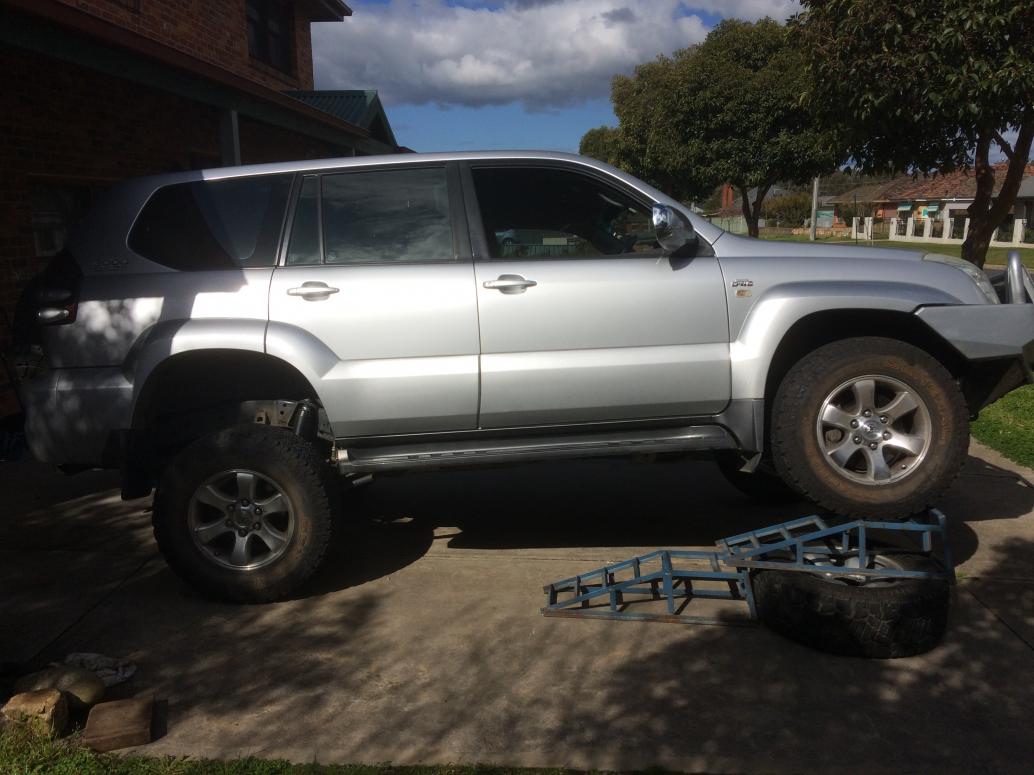

                      • Okay, thanks for that Mark. That's what I was hoping.
                        A couple more of the flex pics :-)

                        Tim

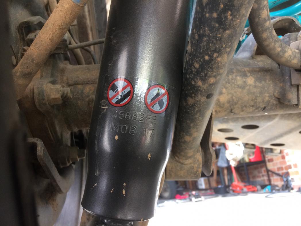

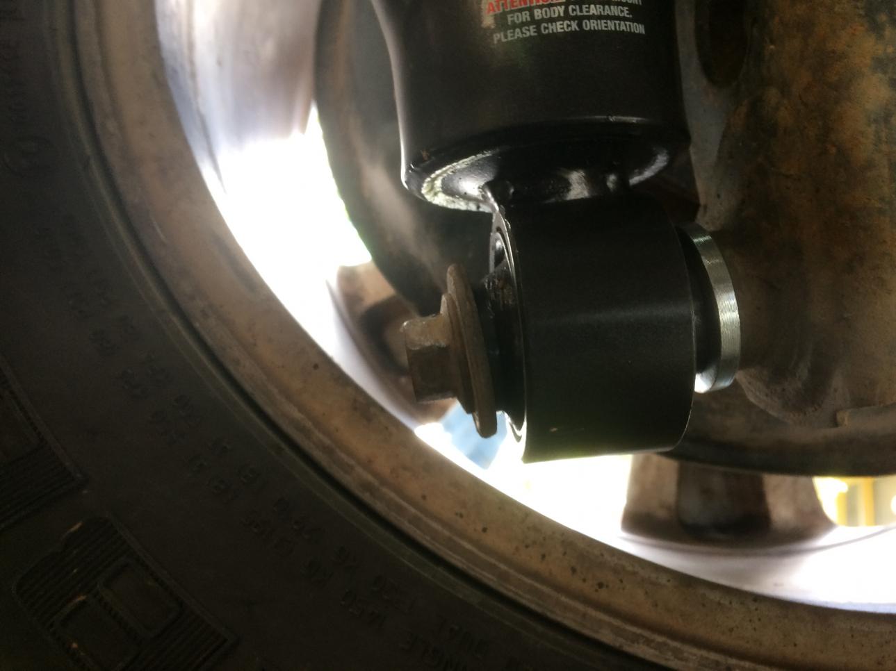

                        • Hey again Tim,
                          Here's a few shots of the 670mm 45682LFE shocks flexed out on the rear of my 120;
                          Side on view of the articulated side showing the shock body-trailing arm gap closing up. It looks like it is touching;
                          However, close inspection from the top shows there is a few millimetres worth of gap;
                          This is on the drooped side with full articulation, and the gap is between the 670mm 45682LFE and my Superior offset trailing arms, which are a larger diameter than the OEM arms.
                          As your OEM arms appear to have shifted over more than what I expected, it may be worth inspecting the state of the OEM trailing arm bushes. They do tear, particularly the uppers, and end up flexing more than they normally would.
                          In any case, the worst you'll do is rub a bit of paint off!
                          Best
                          Mark
