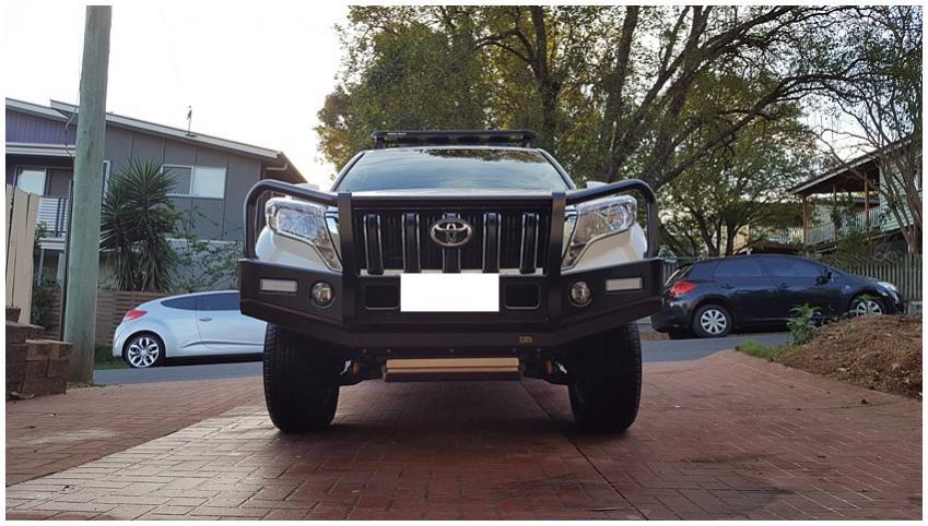

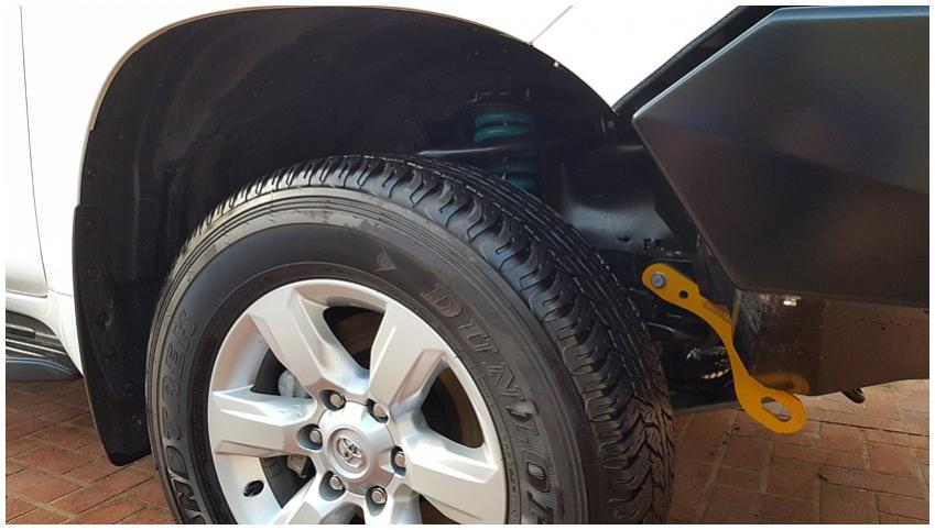

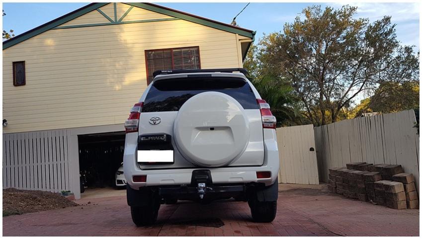

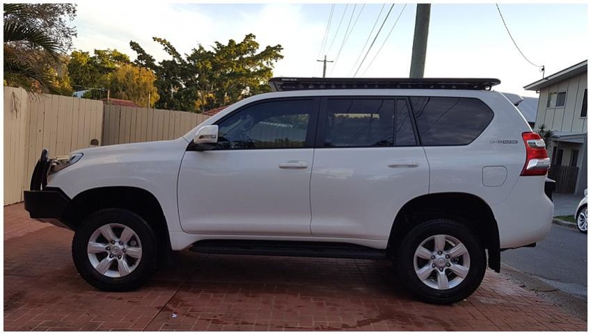

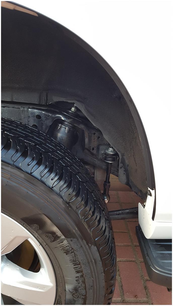

                            • Thought I'd throw some feedback of my own in there too guys. I received my goodies just over a week ago and found the time Saturday to catch up with a mate who helped me install the new setup. I've got a 150 and went with the 352/327 setup. I don't have a dual battery (yet) and the car isn't driven as a daily driver. When we go camping, she's loaded to the hilt with camp gear.
                              We gave John a quick call mid-way to verify what he does with all the additional rubber bushings that come with the kit (unnecessary). We set the lengths on the front to 215 (actually managed to get it there by fluke the first go...). I should have grabbed some photos of the stock and Ironman gear side-by-side - it made the stock stuff look pathetic. My mate couldn't believe how solid the Ironman kit was. He might even install some on his own Hilux.
                              The install went well and the car juuuuust fits in the garage. There is a decent lift there and I'm hoping it will settle slightly as I had to take my awning off for safe measure to get in the garage. I've got 4-5mm difference at the front (higher on right - probably settles when I jump in to drive).
                              I took the car over to Mark for him to inspect his handy work with some urban obstacles in Brisbane. We slammed into some gutters and over some concrete islands (safely) and the wheel simply travelled up with minimal bounce felt in the car. I'm really impressed with how such large obstacles were soaked up by the suspension. I can see how corrugated roads and potholes would now be fun to drive on! I'll be planning some short drives with my in-laws who have a standard 150 setup to do some more comparisons soon.
                              TLDR: another happy customer! Thanks for your hard work Mark!
