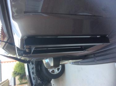

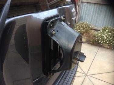

                    • Rear Tyre Spacer
                      Made a rear tyre spacer.
