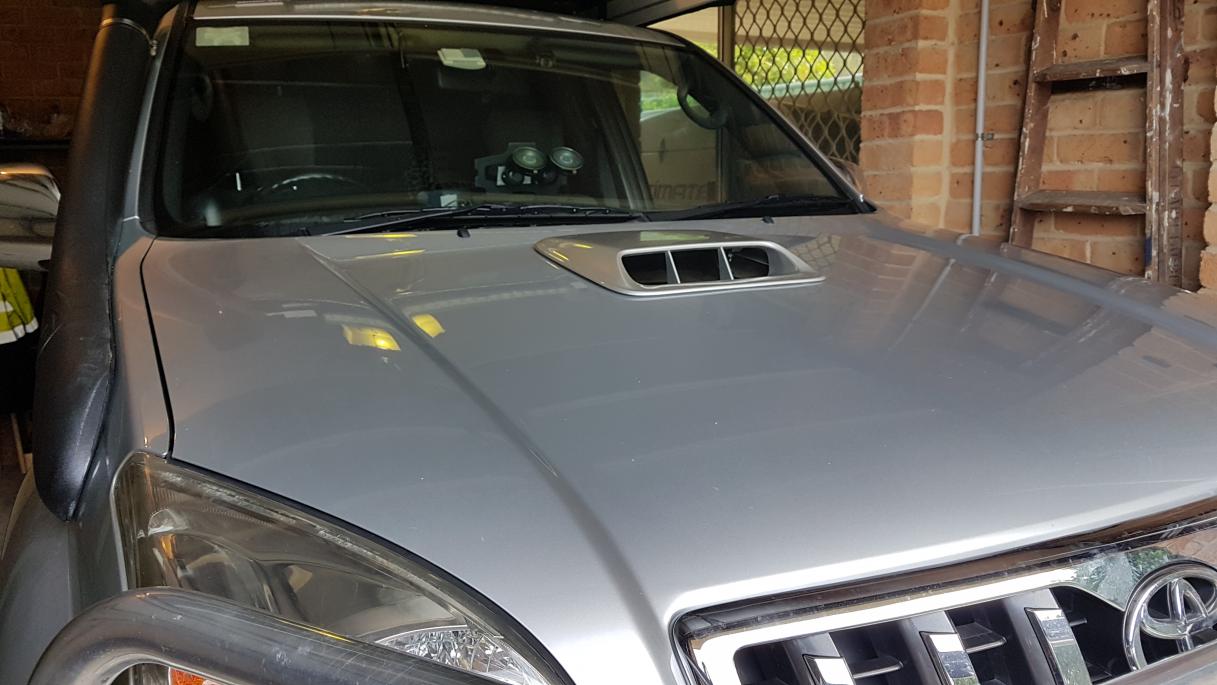

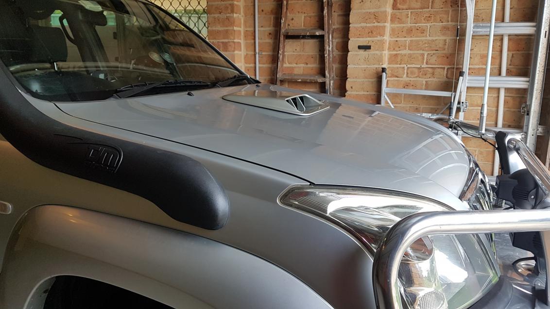

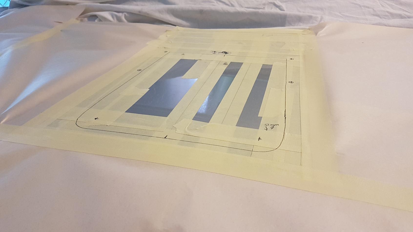

              • Joined the bonnet scoop club this weekend..
                $65 + postage for the scoop from a wreckers online, the donor hilux being the same colour as my car, though there is a slight difference in colour due to fading of either my bonnet or the scoop.
                No painting required other than treating the cut/drilled edges with rust preventative and touch up paint. Gave the edges a coat of wax protective spray as well. The only other cost was $10 for a couple of metres of EPDM 12x7mm foam strip to seal the scoop to the bonnet (12mm was too wide but it was the narrowest they stock in that profile - I just cut it in half lengthwise).
                Lets see if there is a reduction in intake air temps and maybe EGT's too.
                • Well done and nice prep work too. Looks just like it was there from the factory.

                    Thanks. There's no second guessing when your attacking the bonnet with the angle grinder - measure 20k times, cut once..

                        looks good! Haha measure 20k times, cut, then hope to god that those 20k measurements are right :lol:

                            • Awesome job on the scoop, it looks like it rolled out of the factory with it on.

                                That looks great. Out of interest what improvements will a mod like this bring?
