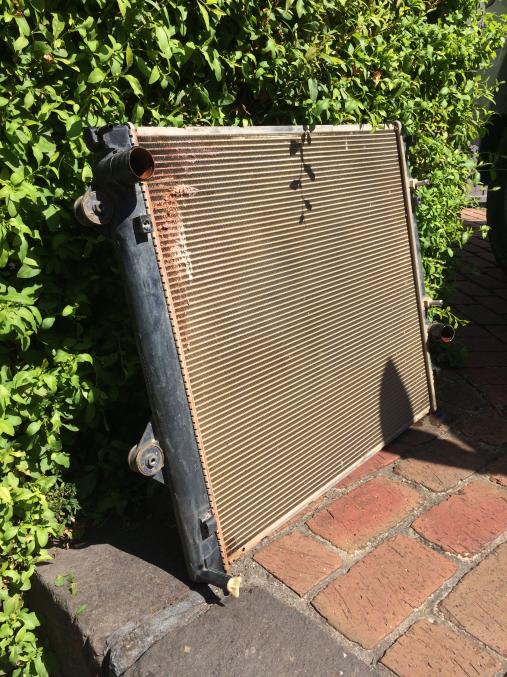

      • Replaced my radiator.
              Great job ! - I did mine about a month ago (2004 1KZ-TE engine, automatic) - it looks quite different, mirror image almost. On mine the drain plug is on the passenger side and the transmission cooling on the drivers side of the radiator. Is yours the 1KD motor/D4D?
              Did you change the thermostat at the same time? That was horrible!
              Mine was leaking for a year so i started using water rather than coolant (Mistake) it was just a big rusty mess

                Cheers! I believe every engine has a different radiator in these cars. I've got the 1gr v6 so the drain plug, trans and lower hose are on the passenger side. I didn't do the thermostat as nothing was wrong with it but they're a piss job on the v6 anyway. My radiators been leaking for a while but only recently started pissing out. At Least my coolant was red as blood and clean. I'll keep a close watch on the cooling system now any future problems

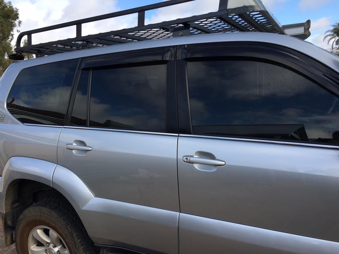

                            • She got some bling on the weekend, fitted the Lexus GX470 windows/door weather seals/mouldings before we start to get some bad weather. Here is the how to thread to help others because I struggled to find how to remove the rear trims: http://www.pradopoint.com.au/showthr...l=1#post570776

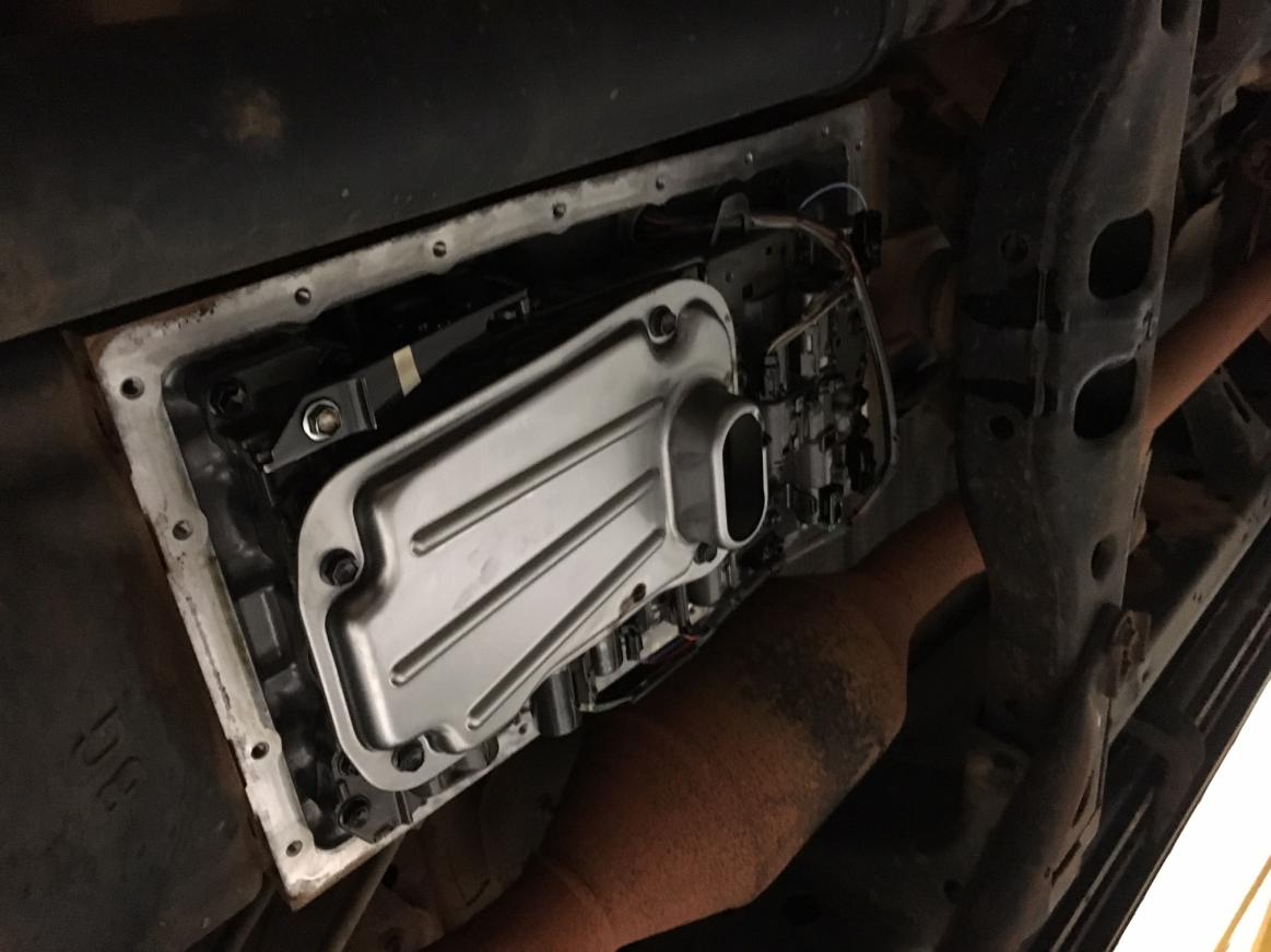

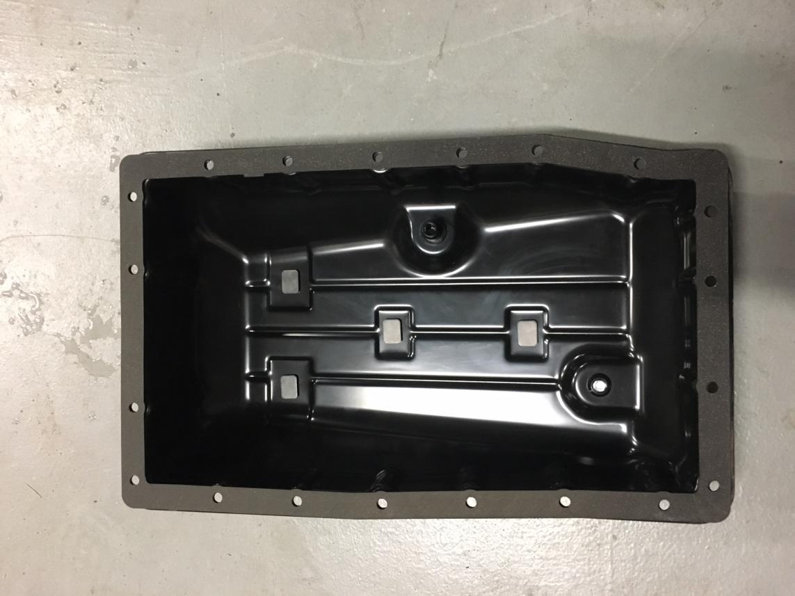

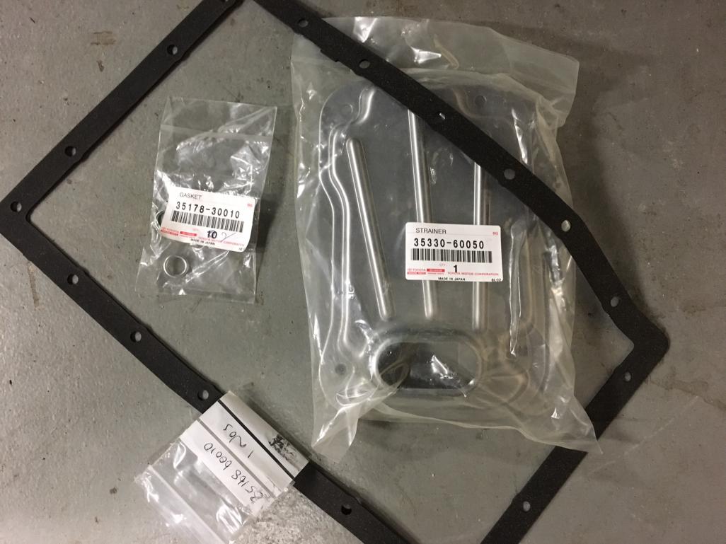

                              Also did the Auto Flush with pan off and new filter, plus pumped out the 12L using the radiator line method.
