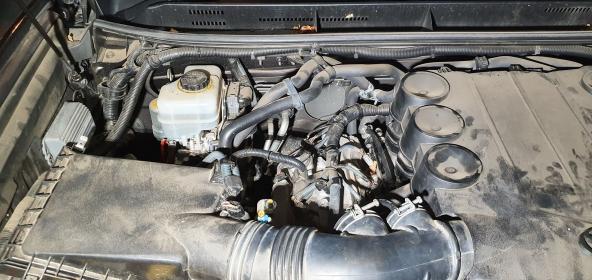

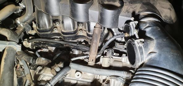

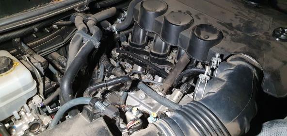

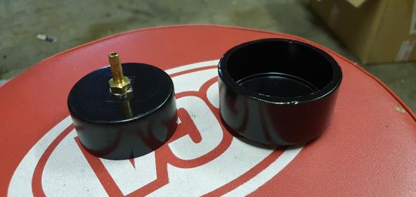

  • Finished removing the intake chamber, didn't realise it fed the fuel reg so had to grab a nipple from the spares box and some suitable hose.
    Bunnings caps filled the holes, cut one down to fit nicer.
    Definitely more induction noise in the carport lol

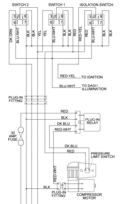

                            Firstly was to swap out the ARB compressor switch, it's ugly and too bright at night time - yes I'm aware I can just pull the illumination from it, but the switch is still ugly as. The wiring is interesting, ignore SW1 and SW2 as they are for lockers. I expected a basic trigger wire to a relay, but note how it actually triggers the pressure sensor directly, then the earth for the pressure sensor is the trigger wire for the relay for compressor power - it makes sense, but took me by surprise.

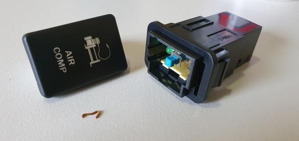

                            I ordered a switch from Air Onboard but was unfortunate enough to receive a dud, it worked once then I could hear something rattling, then it stopped working. Seems like the switch mechanism failed, then bridged some contacts and shorted the switch. He asked me for a bunch of photos andimplied I'd damaged it myseld until I showed him the but of copper that fell out, he replaced it immediatelty after that, but I assume he gets a lot of guys runnning power straight to it, rather than using it to trigger a relay.
                            With that sorted I then found the plastic surround had been modified to fit the ARB switch such that you could not add a factory switch or blank back in that slot. Here's the part number for that surround - $25 from Toyota - and some side by sides. The light green is a fairly close match.
