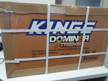

      • #48
        This is part of my winch order, but of course the winch itself is on back order lol
        There's a bushman mechanic tool kit so I can put my good tools back in the shed and leave these at the house/in the car/use for race days. A throttle controller, just because I really wanted to try one. An offset fairlead as I read mixed things about whether standard will work or not and as a freebie I got one of those battery boxes that has the 12v/usb/anderson plugs on it, like a big portable battery bank, which I'll sell.
        Had a look at the tool kit, it's not bad and the bag is quite generous also.

                          Happy days.
