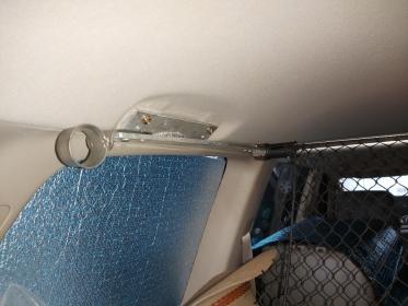

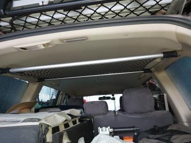

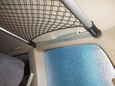

                            • Been toying with idea of storage in rear under hood lining. Was going to make something solid but found a Subaru cargo restrainer and went with that.
                              Made two brackets to replace the rear passenger hand holds.
                              Welded up fitting for the restrainers ends to fit into and just shortened the poles to suit.
