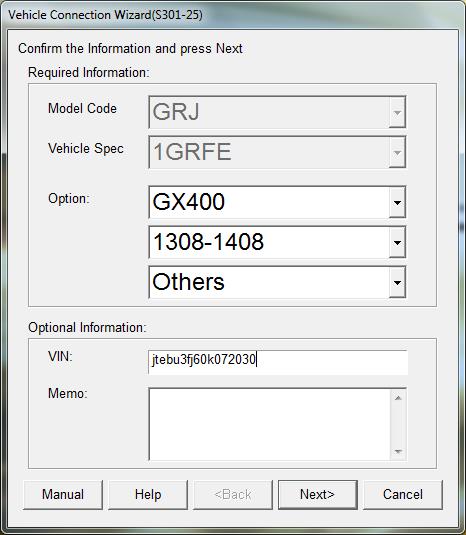

                  • New to Techstream - Advice Needed
                    Guys,
                    New to Techstream and would like some help with the following;
                    My vechicle is;
                    2014 Prado GXL
                    V6
                    5 speed auto
                    Plate 02-14 Build 01-14
                    I can connect to Techstream OK by entering the information as shown in 01.jpg.
                    Can you advise if the settings I have used would be correct.
                    Once I entered this information I can go to the ECU screens. What I am trying to do is
                    turn off the annoying ding ding noise when the drivers side door is open and the ignition button is
                    in accessory mode but I cannot seem to find the setting anywhere.
                    Rick
                    2014 Silver V6 GXL, Pacemaker Ceramic Extractors, ARB Deluxe Bar, Toyota Towbar, Stedi Light Bar ST3302 24 Inch, Tinted Windows and DingoTrails Seat Covers
                    • Sorry, you cant turn off the open door chime from Techstream. Instead you can easily remove the gauge cluster and stick a little self tapping screw into the piezo buzzer on the back of the cluster. Takes on 10 minutes to do.
                      • Thanks mate, yeah I thought that might have been the case, looks like I will go with the screw trick.
