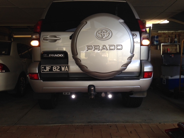

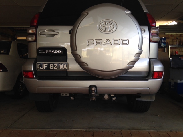

Nice work. Be careful off-road with those low hanging lights though.Dave
Originally posted by Bushbasher View PostNice work. Be careful off-road with those low hanging lights though.
yup, just needed some more light out the back. they dont sit any lower then the towbar so should be fine for the moment. Until i put some on the bracket above the spare light.

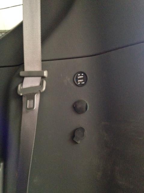

USB Charger
Have had a set in the back of my Prado for over a year. They stopped working whilst I was away recently. Went back to the auto electrician who fixed but said the problem was I had plugged in an Ipad which needs 2 amps and a mobile phone which needs 1 amp at the same time. The total these can handle is 2 amps. 2 phones fine but only one other device on its own.Terry

[QUOTE=OldGreyFart;497223]yeh i got a usb port in my waeco fridge which charges the ipad and ill just use these for my phone. need to put a switch in for them as they are connected to my 2nd battery and the led light stays on all the time, dont really want that. thanks for the tip tho.Originally posted by joel231 View PostDid a couple of improvements today to the 120.
USB Charger
[ATTACH=CONFIG]18808[/ATTACH]

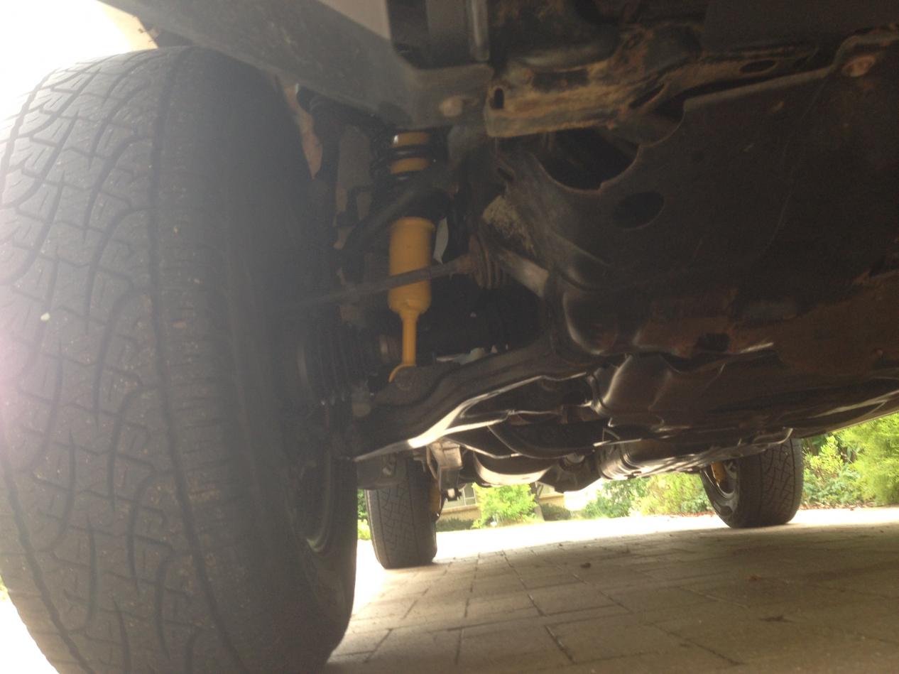

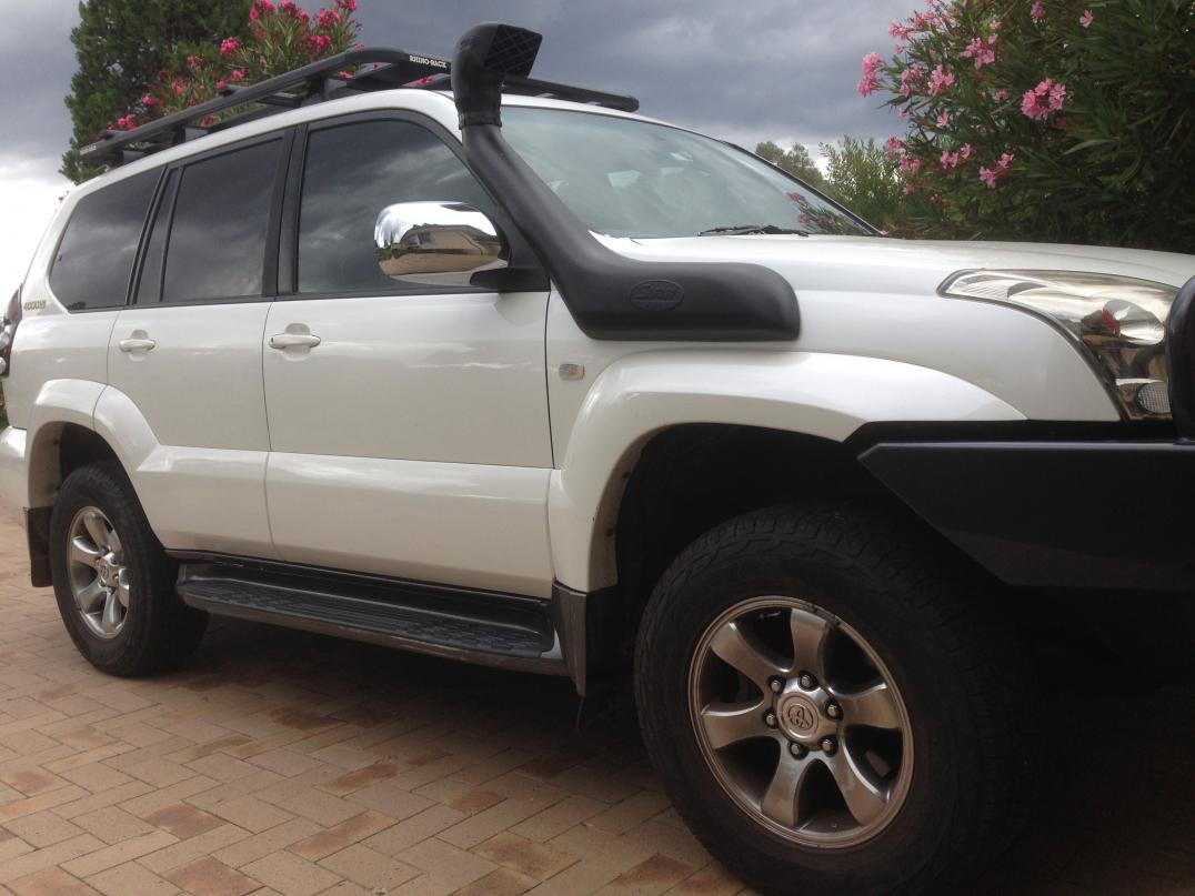

Old Man Emu suspension upgrade fitted today (new 2884 coils and 90000 sports struts in front, 60004 sports shocks in rear). Front is now at approx 790mm (was around 720 from memory). It looks so much higher. Hopefully be able to try it out at Bendethera next week (weather permitting).
Also slowly working up the electrical fit out in the rear - fuse box is in the rear and cables are in place waiting for me to put on the connectors.2008 4.0L Grande, Pirelli Scorpion AT tyres, ARB Deluxe Winch bar, Warn XD9000 winch, Safari snorkel, Old Man Emu Suspension (original airbags in rear), IPF Driving Lights, Rhino Pioneer Platform Rack and attachment bars, Adventure Kings rooftop tent (when required), Waeco CFX65DZ and slide, Hayman-Reese cargo barrier, custom storage and Ark battery pack in cargo area
